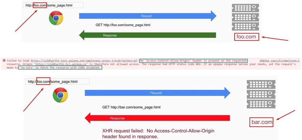

@Siddharth Barahalikar- can you please explain why it's working from postman?
@sandeep pandey
Lets say the API is deployed in Apigee with is hosted on www.api-apigee.com
Now when you try to hit this from Chrome/Browser/Postman/cURL/SoapUI you will get 200 OK and data back.
But when you try to hit it from Angular UI or any other UI which is hosted on localhost or www.some-ui-domain-name.com The browser throws an 401 error because the API is hosted on www.api-apigee.com domain and it is being requested from a different domain. This is called Cross-Origin Resource Sharing.
For security reasons, browsers restrict cross-origin HTTP requests initiated from within scripts.
The reason it works from Postman/cURL/SoapUI is because it is not hosted anywhere, these make use of the Chrome/Browser Internet settings. It is making a direct call., not through any hosted service.
