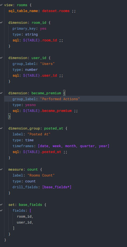

I tried to do it on my own in my spare time since it seemed like a cool project. I did it with the help of the code that Ladvien has already written (https://github.com/Ladvien/vscode-looker)
This is just a first try and proof of concept. The colours are crazy just so that I can easily differentiate between different patterns 🙂 In terms of grammar recognition I believe It’s close to what we have in the LookML editor, and perhaps slightly more. (recognising the SQL in SQL parameters (where we could use SQL grammar recognition that I think Ladvien had in mind), values in arrays, and so on)
Let me know what other things would be useful in terms of syntax highlighting and here is a list of what I’ve done so far:
  1. Scopes (anything that has opening and closing bracket {}) - would apply to view,  explore, parameter, dimension, measure, set
    1. Type - yellow
    2. Name  green
  2. SQL Parameters - any line that starts with sql and finishes with ;;
    1. Name of the parameter - orange
    2. Value - red
      1. Liquid - pink
      2. LookML variable or field reference - purple
  3. Parameters - all other parameters
    1. Name - blue
    2. Value - lighter blue
      1. Strings - brown
      2. Yesno - Pink-ish
      3. Array - light purple
      4. Variable - purple

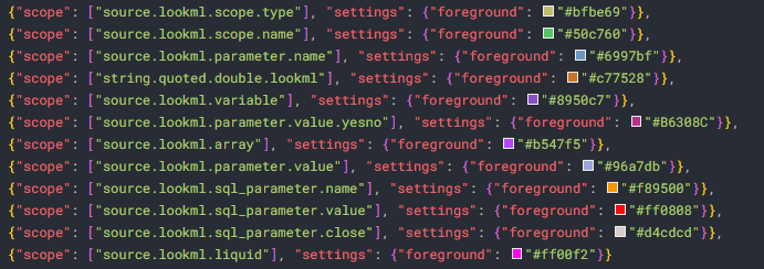

These are the settings that then can be used to change colours of the different part of the syntax:
