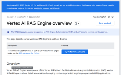

When viewing the document at https://cloud.google.com/vertex-ai/generative-ai/docs/rag-engine/rag-overview
Clicking on the Try Vertex AI Rag Engine, it directs to this page:
https://console.cloud.google.com/vertex-ai/rag?inv=1&invt=Abx1uQ
Which sends me to this URL:
0 1 238
