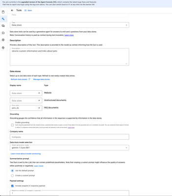

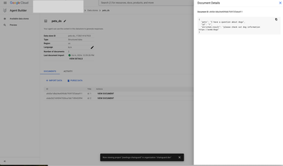

Here's some screenshots to show the basics that I'm trying, I'm probably holding it wrong but I've not been able to get any responses from the Pets TOOL that's configured with Pets_DS which is structured CSV:
Agent:
 Tool:
Data Store:

1. Tool Configuration and Data Store:
  • Tool Type: The "Tool" shown in your screenshots appears to be a "Generic Tool" with a Data Store. While this setup can work, it may be too broad. Consider developing a specialized tool specifically tailored for your structured CSV data, as this will enhance control and integration.
  • Data Store Integration: Ensure that the "Pets_DS" Data Store is correctly linked to your tool and configured for access. If you stick with a "Generic Tool," make sure to specify the data store name and any required credentials.
  • Data Store Schema: Verify that the structure of your CSV data matches the schema defined for your Data Store. This alignment is essential for accurate retrieval and processing.
