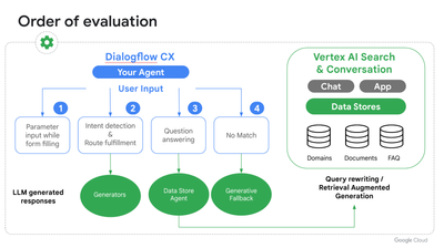

so when you are on a page, you will the user need to say something that triggers the data store. here is the order of evaluation:
You can check the grounding level too:

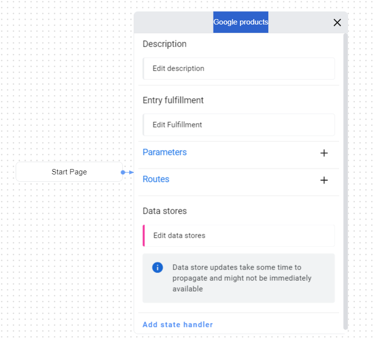

I have a separate page called Google Products which has the data store. The start page has a route  that directs user's questions relating to Google products. Now when I reach the Google Products  page how do I trigger the data store?Screenshot 2024-03-26 230022.png

Hi @atanu585 ,
with your design, it is a 2 step process for the user. First, the user need to say something to do the transition to Google products page. Then after transition the user need to say something related to google products to hit the data store. Probably you can remove the transition step and just add the data store handler in the start page!

can you make sure that the data store is linked to the handler?
Yes it is
