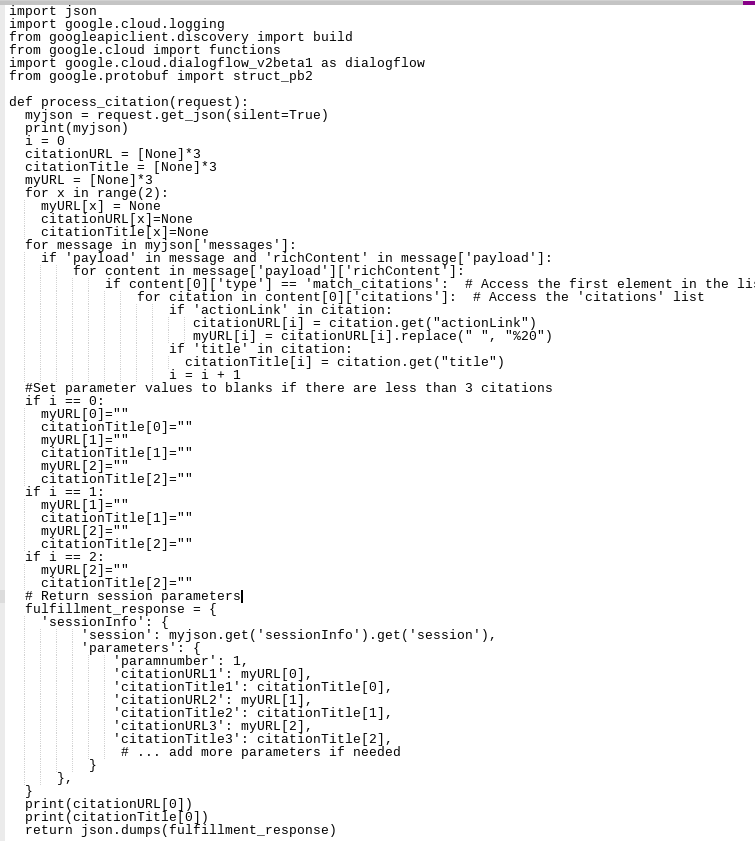

So, after exploring a lot of options and with a lot of help from Google Gemini, I landed on a solution that worked for me.  One of my challenges was that I wanted to process the citations that were generated from my data store.   You have more flexibility with session parameters and using conditional payloads when using Routes+Intents vs data stores.  To work around that, I created 1 custom payload in my data store fulfillment that created hyperlinks to the 3 documents cited.  If there are less than 3 documents cited, it just returns blank lines.  Here's my entire process with some details (please don't judge my code - I'm not a developer 😉

  4. Enable a webhook that points to a Python Google Cloud function that processes the agent response and populates the session parameters for the 3 citation titles and 3 citation links.  Here's my Python Cloud Function Code (I probably don't need all of those imports - those were left over from some other testing):

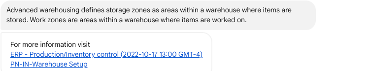

The results look like this:

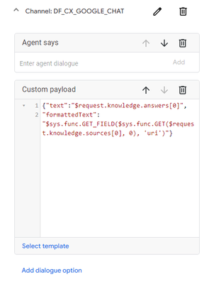

I'm trying to use GoogleChat integration and I have similar problem with receiving a link to document in a response.
Could you please advise what I need to do in this Custom Payload?
Thank you in advance!

Hi 🙂
I added data sources with unstructured pdf files,
when I'm testing the bot via dialogflow messenger, I see the text response with information from pdf file and also clickable link to the document.
when I'm trying to use google chat integration the response from bot is only text, sometimes it's "Here is  a link that might be helpful" but there is no link.
I'm new to dialogflow so any information / advise on how to receive links in google chat integration will be helpful.
Thank you!
Hi
you have to create a different response per channel. Please see the docs here: https://cloud.google.com/dialogflow/cx/docs/concept/fulfillment#channel-specific
That custom payload should include the structure that Google chat supports.

I added response per channel for google chat:
but could you please also advise how to add a link for a document to Custom Payload json?
as I understand fields could be taken from here:
so I can use any of string fields, for example "formattedText": string, ?
and how to refer to a link, I tried "$richContent.actionLink" and
"text":"$request.knowledge.answers[0]",
"formattedText": "$richContent.citations.citation[0].actionLink"
but it didn't work.
try this:
$sys.func.GET_FIELD($sys.func.GET($request.knowledge.sources[0], 0), "uri")
$sys.func.GET_FIELD($sys.func.GET($request.knowledge.sources[0], 0), "title")
thanks again for your response,
I tried both
but unfortunately I still don't receive a link in response in Google Chat
am I doing something wrong? I tried all options with and without quotes in $sys.func.GET_FIELD($sys.func.GET($request.knowledge.sources[0], 0), "uri") 😞
or the only way to receive a link in response is the way described by french_williams in this thread?
yeah,
My answer is more so if you want to get this from the flows and pages. If you want to get it from the webhook you have to follow what @french_williams did!
Best,
Xavi
