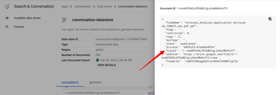

  • Datastore Entity Structure: unstructured files with metadata

did you check that this field exists?
fileId
Yes, it does
okay so probably the character: -- it is used for another thing, can you try to use another field like fileName?
keep me in the loop!
Same result.

can you try:
"filter": "fileName: ANY(\"ww_798019_ndx\")"
I get the same response as above..
I am not sure then. What I would suggest is to create a Search app using the same datastore and play with the API until you have the filter working
The filter is working just fine using a Search app...
Then I will recommend to open an issue here: https://issuetracker.google.com/savedsearches/6123401
Having the same issue. Was this solved?
