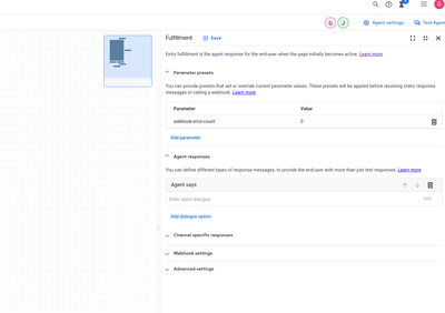

webhook-errors, I don't understand how they manage the errors, I got confused without examples. Currently I have this part where I know that if there is a webhook error, the transition is to the webhook_error page, but I don't understand how to make it general and repeat a webhook function 3 times.  Is this correct ?
In my top flow, I have the preset parameter setted before the next one that have the webhook action.
Then where the webhook action is, I have an event handler that it will make a transition if there is a webhook error to the page if_webhook_error
Finally, I have my if_webhook_error page, that it will take the counter in the fulfillment response, and also two conditions, the ❤️ will return to the previous page so I can reuse this pages for every webhook error in that flow. And the =>3 that will end the session.

That's correct, I am trying to follow what it said in the best practice section here: https://cloud.google.com/dialogflow/cx/docs/concept/agent-design#webhook-errors
But there is some part that I don't understand like this part:
  • Do not supply a transition target from the state handler that triggers the webhook call, otherwise, the webhook error event handler will not be invoked. Instead, set the transition target in the webhook response from the webhook service.
It this best practice? The previous page will have to have the webhook on the page fulfillment for it to fire on entry.
that depends on the use case. I would suggest most of the same:
  1. try the webhook 2-3 times (probably 2 as maximum)
  2. If it still fails, move to another flow/page to tell the user how to contact you
it should not be too complex from the user's perspective. When you design a conversation, think about the en user journey and how they are gonna interact with your assistant
