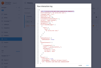

And finally, I also think the id of get_conversation is a single id but cannot be the one you are showing. You can check that is different in each interaction of the conversacion. Any way, I have checked with the one of those ids and i get:
NotFound: 404 Conversation [308d2bf1] not found in project [agen-test-xfrc].
com.google.apps.framework.request.StatusException: <eye3 title='NOT_FOUND'/> generic::NOT_FOUND: Conversation [308d2bf1] not found in project [agen-test-xfrc]. [resource_name: "projects/agen-test-xfrc/conversations/308d2bf1"
