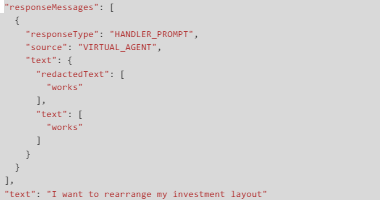

But my concern is I see the "redactedText"  field even if I have not redacted anything that is in the above picture.
and sometimes the redactedText field is even not present in the responseMessage
So how should I write logic coz if I directly read the "text" field then sensitive information will be displayed and if I read "redactedText" then code will break becoz sometimes it doesn't shows up ,
So I guess it has to be an if else condition if "redactedText" is present extract that or else the "text"  field
Your thoughts?
Pls refer below images @xavidop
1000000022.pngone is with redactedText and other one is without
If you are not using the redactedText feature what I would suggest is just always read from the text property. Forget about the redactedText property
