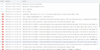

I am encountering an issue while attempting to access data in the `ModelEvaluationClassificationOp` which is a pre-built gcp component. The error message I am receiving is:
"LookUpInode: input/output error, Error in iterating through objects: storage: bucket doesn't exist."
This warning message might be misleading and unrelated to the real error that caused your component to fail. It was fixed in the newer versions of the `google-cloud-pipeline-components` Python package. I recommend upgrading this package to the latest version `2.14.0` and import the `evaluation_automl_tabular_classification_pipeline` from there.

Looking at the failed evaluation step details in my UI-generated runs, I can confirm it's using the container image gcr.io/ml-pipeline/model-evaluation:v0.9.4.
Based on your previous answer, it sounds like this version might contain the issue causing this misleading error. While upgrading the google-cloud-pipeline-components Python package fixes it for SDK users, this doesn't seem to apply when initiating the run from the standard UI components, as the run still uses the v0.9.4 image.
