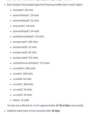

This is not about vertex AI quota , at the backend it is using dataflow job and quota exceeded for dataflow job i.e. 24 check below snapshot
and link here
https://cloud.google.com/dataflow/quotas
Try using region with more quota.
