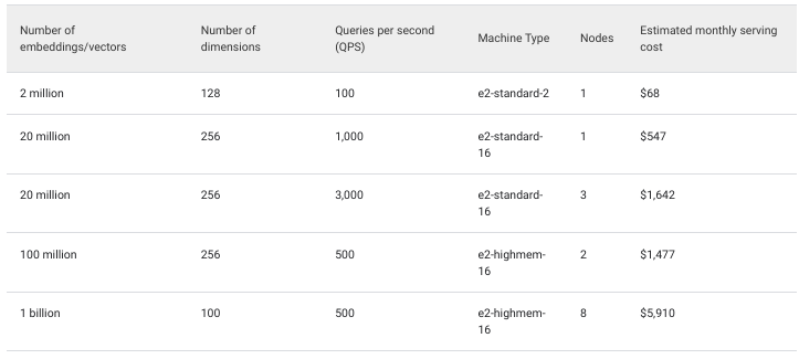

Hi @trk,
Based on this documentation, you are right that:
Vector Search pricing is determined by the size of your data, the amount of queries per second (QPS) you want to run, and the number of nodes you use.
In addition, I’m not seeing any straightforward way to calculate the exact cost of ingesting 20GB of data into Vertex AI Vector Search.
To get your estimated serving cost, you need to calculate your total data size. Your data size is the number of your embeddings/vectors* the number of dimensions you have* 4 bytes per dimension. After you have the size of your data you can calculate the serving cost and the building cost. The serving cost plus the building cost equals your monthly total cost.
Serving cost: # replicas/shard * # shards (~data size/shard size) * hourly cost * 730 hours
Building cost: data size(in GiB) * $3/GiB * # of updates/month
Here is the sample Vector Search pricing examples including QPS:
While I don’t have visibility on how this has been calculated, I would highly suggest connecting with our sales team to get a custom quote for your application. You can also use the Pricing calculator to generate a cost estimate based on your projected usage.

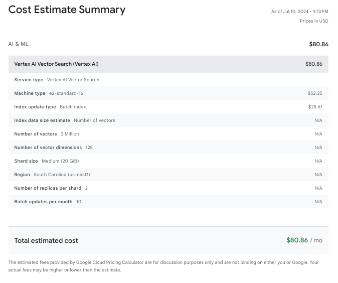

Vertex AI Vector Search uses a pay-as-you-go pricing model, you only pay for the services you use. Based on the pricing calculator, I’m not seeing any index hosting costs associated with maintaining the index.
Instead, I’m seeing this Vertex AI Vector Search configuration which includes :
  • Number of vectors
  • Index size
  • Number of vector dimensions
  • Shard size
  • Region
  • Machine type
  • Number of replicas per shard
  • Index update type
  • Streaming updates per month
Here is the sample cost estimate summary from Pricing Calculator for reference:
