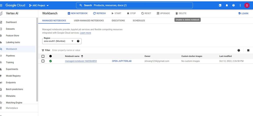

Below is the Screenshots of the way i have setup Jupyter Notebook instance and Elasticsearch instance.
1.
Vertex AI Workbench - Jupyter NotebookVertex AI Workbench - Jupyter Notebook
This is a link of the screenshot of the Vertex AI workbench where I have created a Jupyter Notebook instance.

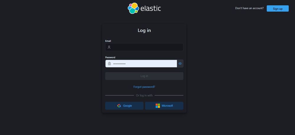

2. Below is the screenshots of the way I have accessed Elasticsearch through marketplace. Once I click on the service provider, the second screenshot is the landing page of Elasticsearch Cloud where also, I have signed and created the account.
Elasticsearch in Market PlaceElasticsearch in Market PlaceLanding Page of Elasticsearch once we click on providerLanding Page of Elasticsearch once we click on provider

Using the Elasticsearch managed service from the GCP marketplace, you would need to use the [provided guide to connect using a Python environment (in this case being the Jupyter notebook). Additional methods of connecting to the JSON API of the service are also included in the documentation.
If you would like to exclusively connect directly to the deployment using port 9200, creating a deployment within a VM instance in GCE should be more appropriate. This is due to the fact that a Vertex Workbench Notebook is also hosted on a GCE instance, and can be set up to be in the same VPC as a VM hosting Elasticsearch.
