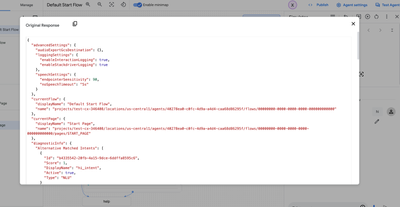

You can check if the data store is being hit by clicking this button in the simulator:
You will see the logs and there you could see the data store response if any:

I also checked in logs ... Seems structured datastore is not getting hit. All questions are hitting another datastore with unstructured data. manuals_1707201760846 is my unstructured datastore.
Not sure what step I am missing. Mentioning again that I am getting response from unstructured datastore which i created from cloud storage but not from structured datastore created from BigQuery.

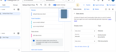

In Dialogflow CX , I have not done any additional settings.
I hope I am providing the details you asked for.
that is the issue! you have to link the data store. I saw that you only have linked the manuals data store and not the BQ one. I would recommend to only link one or another.

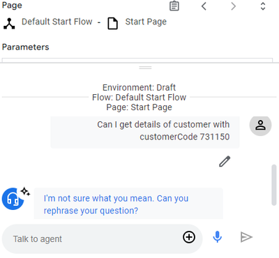

Ok. Now i can see datastore being hit when I am asking the questions but still getting negative response.
One question , My bigQuery data is not FAQ types . Its more like customer details like his name , address etc etc. Its giving negative response in this case.
I also tried qith another structures data where its more like two columns with question n answer types. Giving negative response for this as well.

For every question asked I am getting below response . Customer with code 731150 exist in databse.
Below is the Log
Okay so here are a couple of things:
1. the no match event is the event that is being triggered. this means that Dialogflow CX agent does not undertand what you are requesting and the information in the data store is not enough to answer that request
2. the use case that you are using for the data store is not a good one. what I would suggest is to get that information using a webhook and accessing BQ or any db from it. I think you wrongly understood what a data store is. A data store can be used as a backend-retrieveal information. I would suggest to take a look at this video to understand the usage of it: https://youtu.be/w8D-p0rqQKI
