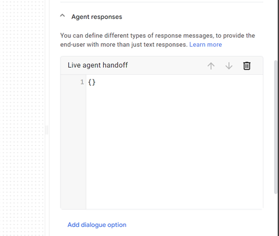

However, in the documentation it is not clear what is actually signaling these live agent handoff measures in the analytics. I see here that you can provide a response in fulfillment section for a live agent handoff:
https://cloud.google.com/dialogflow/cx/docs/concept/fulfillment#handoff
but all I see when I enable this is the following:
I’m guessing this is some sort of JSON message for the integration that is being used. I tested using this fulfillment and the prebuilt Flow Failed Human Escalation event and it does not seem to record that their was a "Live Agent Handoff" in the analytics section. So what is that actually measuring and how do I get it enabled?

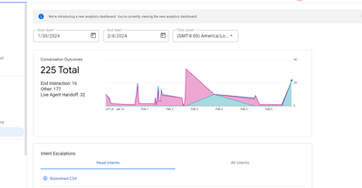

Interesting. Guess it takes a whole day to process. I see it now from my testing:
I wonder why I can see conversation history right away but not analytics. Maybe it just takes some time to process.
Hi Karl,
yeah, that payload is a custom payload that will be sent to your Live Agent platform. In terms of analytics, Dialogflow CX is as if it was a transition but in this case, to a live agent. You will need to test it to actually see that number going up.
So to your quesiton, when is this analytic being incremented? this is when you call a webhook with the Live agent handoff payload.
Here are some examples I found:

Here, I actually see that I have 10 Live Agent Handoffs where before i wasn't seeing any. Maybe it takes a couple days to register?
that is something that could be possible as well. On Alexa (I know it is a different platform), it takes like 5 days to see real results. If you have properly configured the live hand-off it will definitely show up there!
