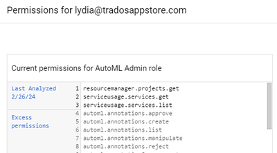

Can you get the payload for the error from Cloud Logging? It should give more information on why the permission is missing.
The missing ones seem to now be available.  I'm not sure what triggerred this... maybe this is helpful as it seems coincidental that these three are separate in this way:
