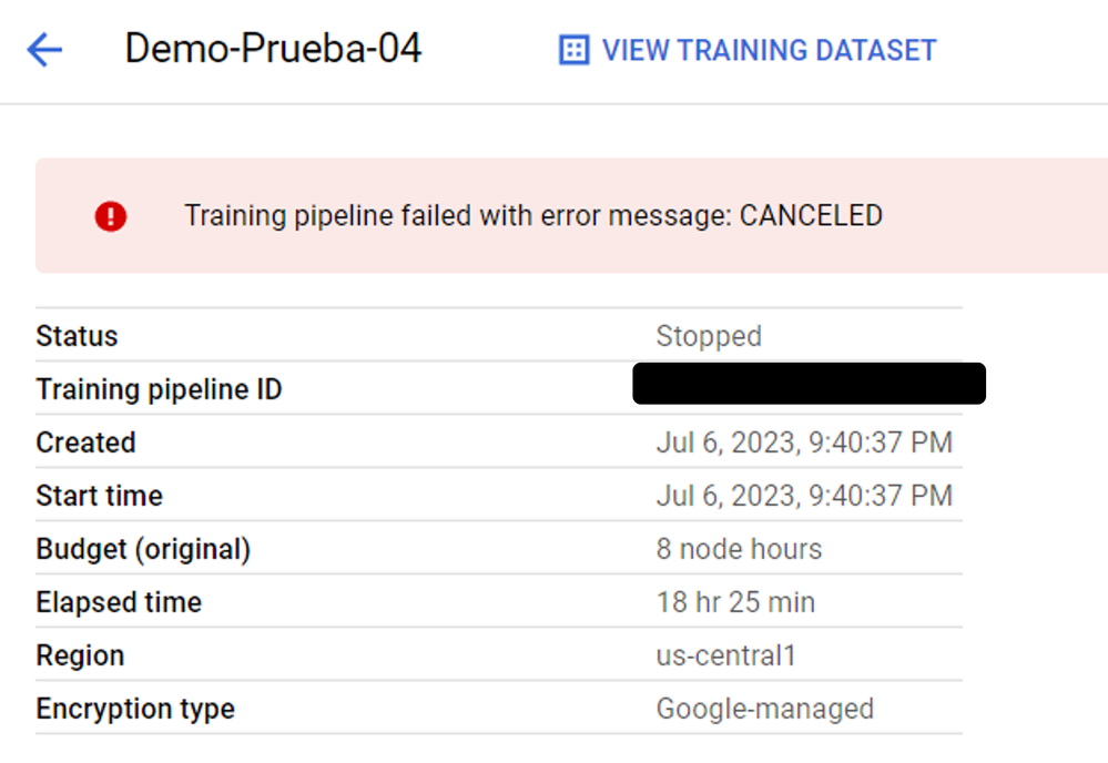

I'm trying to train my first model to classify images with Vertex AI. I set 8 hours as the budget for maximum node hours but the process run for 18 hours and I wasn't sure if I was going to be billed for the 18 hours so I canceled the training. The "Enable early stopping" was enabled.
In addition, I used 13 images by label but I read that the recommended quantity is 100. I guess that the quantity of images might impact the training time.

Thank you for your response @lsolatorio ! Very helpful! My question was more related to future uses of Vertex:
1. If I set the budget to 8 hours but I see that it continues processing for 10, 18 or 50 hours, will I be charged only for the 8 hours and I should let the process continue?
2. I had read the "Prediction and explanation" link you sent. As far as I understand I was only charged for 8 hours x $3.465 for training in AutoML mode.
Thanks again!

Hi everyone,
I've faced with the same problem you're facing and reached out to Google Customer Support. What did I learn from them? Just check the link below, you won't be charged for the extra time that Vertex AI used. The budget hours value in pre-training step will be the maximum amount that will be spent on training.
https://cloud.google.com/vertex-ai/docs/tabular-data/forecasting/train-model#google-cloud-console:~:...
