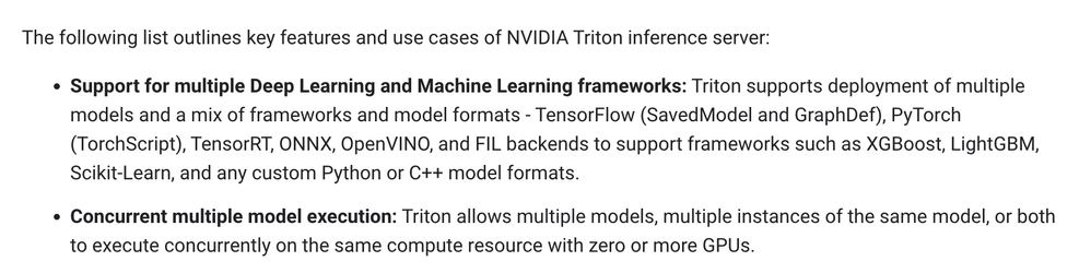

Currently, I want to deploy a Triton server to Vertex AI endpoint. However I received this error message.
"failed to start Vertex AI service: Invalid argument - Expect the model repository contains only a single model if default model is not specified"
Is this mean that the Triton server deploy only support one model? It is different from what I have read in this document about concurrent model execution
https://cloud.google.com/vertex-ai/docs/predictions/using-nvidia-tritonScreen Shot 2022-08-25 at 21.13.18.png
