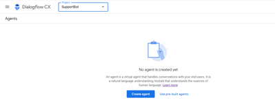

I don't get any errors from the APIs, and I am able to see the Agent listed on the Vertex AI Agent Builder UI.
But, when I click on it, the DialogFlow CX interface opens up and the Agent is not listed.
I also tried directly accessing the Agent Console and DialogFlow CX consoles for the Agent(by using the URLs for a UI created agent as example and changing agent id), but, both of them gave Agent does not exist error.
https://vertexaiconversation.cloud.google.com/projects/supportbot-438921/locations/global/agents/136...)
https://dialogflow.cloud.google.com/cx/projects/supportbot-438921/locations/global/agents/13662f7f-2...
Any suggestions on how I can create an Agent through the APIs?

Hi @Ramesh_Akidev,
It seems that the agent in your project you're trying to access doesn't exist or that you don't have the necessary permissions to view it. With this, make sure that the account you're using to access the agent has the correct permission mentioned here. This may also happen if you have multiple accounts that are logged in in the same browser.
If the issue persists, I suggest contacting Google Cloud Support for further investigation and confirm if this issue is project-specific only.
Hope this helps.
