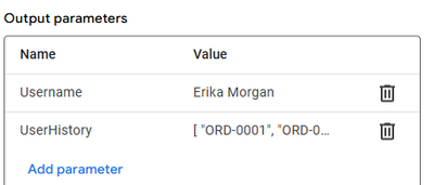

defined output parameters that needs to be passed to the parent playbook.

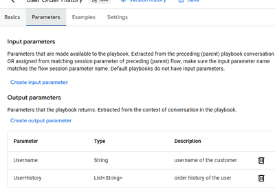

parameters that child playbook returns are defined under the parameters tab in child playbook as below.

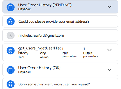

During the conversation as below :

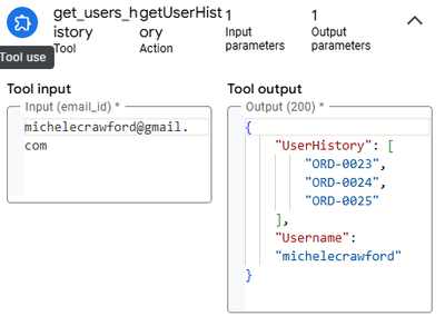

The tool is getting the output properly but the child playbook is unable to emit out through the output parameters during the conversation as defined in the example.
Error messages :
In debug trace

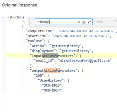

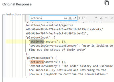

IN original response :
The tool output is 200 status
but the playbook outputActionParameters is empty due to which the error is occurring.
