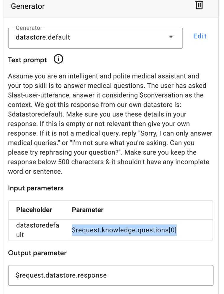

Hi!
To do that you have to set in your generator a variable, to add a variable
you just need to use the $symbol. For example:
Tell a joke about whatever. you have this useful information $information.
Once you add that in the generator, whenever you use the generator, you
will see a box to fill the $information parameter. There you just need to
set that to $request.knowledge.answers[0]. Something like this;

the image that was not attached
Tried this already. It is not picking up the value.
Make sure that saved the generator, if not it will not show up
Working now, I was using the wrong variable it should have been $request.knowledge.answers[0]
