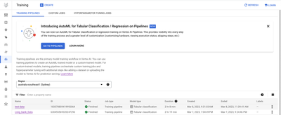

I'm trying to run a vertex AI pipeline (AutoML) using default setting and required service account permission but every time i run that pipeline, i will get failed with above error.
same i had run with custom will success but when running with AutoML for Tabular Classification / Regression it will get failed after long process time.
