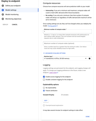

I played around with some configuration options when deploying the model from the tutorial.
I kept the default selected machine n1-standard-8, 8 vCPUs, 30 GiB memory instead of n1-standard-2 like in described in the tutorial.
Also, I changed the amount of Path Count of Sampled Shapley when Feature attribution is ticked in the Explainability options Part.
I don't which of these two settings fixed the error, but I was able to test my model now.
You are right, in my case, I changed the virtual machine from n1-standard-2 to the default n1-standard-8. It now doesnt throw the error.
