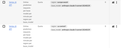

The default value for all claude models in the quotas page is 0. And I cannot change it to any value above zero.

Absolutely. Go to the quota and system limits section under IAM and admins. For service search Vertex AI API and Dimensions search anthropic. Find the model you want in the region you want and check the box and click edit quota
