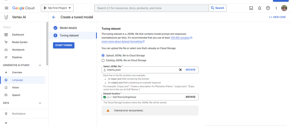

I am getting an internal error encountered while starting the fine-tuning job on the cloud console. I have tried all the ways suggested but still facing the same error. Can you please help me to get rid of this error?Screenshot (254).png
