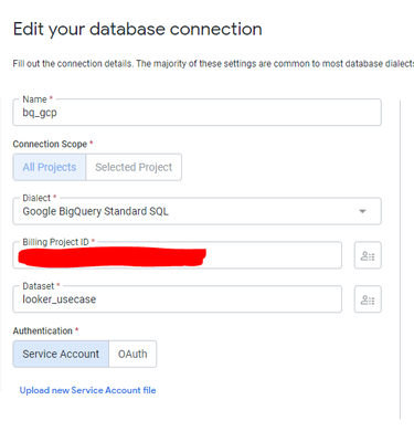

I have a query on configuring the BQ connection in Looker.
How does the billing happen if the Billing Project id I have mentioned in the below screen shot is different than the project id using which the service account was create and configured in the below connection?
If the service account is used to submit queries to BQ then the billing will happen for the Service Account's project ID. Is that true? and the Billing Project ID below will not be used for billing?

Hi @a_shah
Thank you for reaching out to our community.
Here's my take based on your description:
1. I believe billing configuration supersedes the service account project association. All the costs incurred by your queries will be charged to the billing project that you have specified in the BigQuery connection regardless of the service account's origin.
2. Service account project IDs are mainly utilized for authorization and access control, it identifies the resources that can be used and what actions can be done.
Hope this helps.
