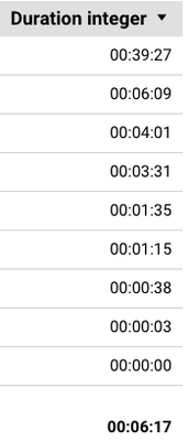

I attempted to reproduce this internally, and I got the 6:17 as the average. Not exactly 6:18, but much closer than 4:39.
I must be missing something about your setup. Can you share more details about the field definition? For example, mine is defined like this:

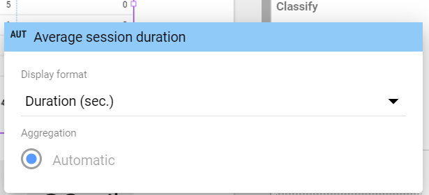

Appreciate it, Sam! But the value i'd like to understand is 00:04:39 showed at Looker Studio when they calculate average, you know? What kind of math do i need to do to achieve that result. That's my setup.
Metric configuration:
Classify configuration:
BTW, i've created a table connected to my GA4.
That is super helpful! I think your screenshots pinpoint the problem. I think that the issue is the "Running Average" in the "Running Calculation" section of your first screenshot. I think that the grand total average is being applied to the average (not the running average), but the column values show the running average.

Here we can see a good comparison:
Example 1 - None
Example 2 - Running average
