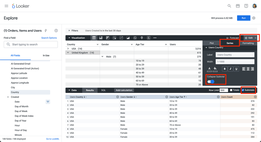

Hi!
I think what you are looking for is using a subtotal table in Looker, here is the documentation
You can also set the subtotals to default to collapsed in the Edit->Series menu
Here's an example, where I've set country to collapse by default then clicked on "United Kingdom" to expand it:
Hi!

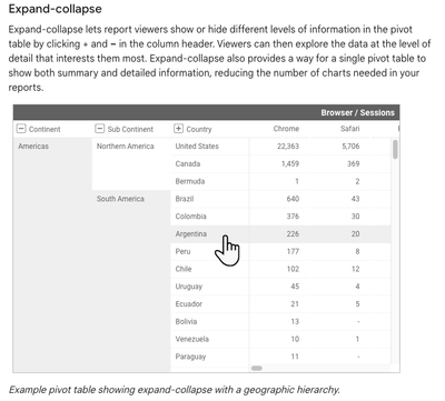

Is there any other way of doing this. Like in looker studio. I am here by sharing the link of the demo of the compressible table.

If you are talking about the expand collapse functionality described in this Looker Studio Doc, then Looker's subtotal as I described is the closest thing.
Out of curiosity, is there a reason the subtotals in Looker doesn't quite work for you, or why you prefer the Looker Studio expand-collapse?
