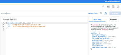

Recently I'm running into an issue where remote changes I make on github are never reflected in the Looker master branch even though I have the proper webhooks set up.
I’m in my branch, and it shows it’s up to date with production, which it is. The ref value does correctly reflect what’s in production:
But when I exit development mode, the contents of the file aren't up to date with the remote master branch:
0 10 675
