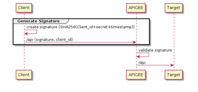

I have the following requirement
1. APIGEE has generated client id and secret for the client application during app registration.
2. client instead of calling APIs through access token. They will call it using SHA256(client_id+client_secret+timestamp). This header will be passed in each request.
3. When this request comes to APIGEE, APIGEE should create a same hash to verify it. there should be a buffer of (+,-)3-4 min kept and allow request with (+,-) 3 min delay or early as per servers time.
Can I have this functionality in APIGEE OPDK with minimum latency.

They will call it using SHA256(client_id+client_secret+timestamp). ...Can I have this functionality in APIGEE OPDK with minimum latency.
Sure you can do it. I am not sure this is a good thing to do. Let's put aside that discussion for a moment. It is possible to do this.
But you haven't provided sufficient information for how the authentication protocol works.

The question is, what is the payload? You said "client_id+client_secret+timestamp".
But that means the request needs to pass the client_id and the timestamp, explicitly. I suppose the client will pass these things in separate headers. like this:
GET /foo/bar
SHA256: ba7816bf8f01cfea414140de5dae2223b00361a396177a9cb410ff61f20015ad
ClientID: ABCDEFG
Timestamp: 20211117-1658
Given that kind of request, then on the Apigee side, you'd need to do this kind of check:
  1. verify the API key (client ID)
  2. check the timestamp that the client passes in, to see that it's valid (maybe: not older than 60 seconds and not in the future by more than 60 seconds?)
  3. compute the expected SHA256
  4. Raise a fault if the provided SHA256 does not match the computed SHA256
In a policy flow, that logic would look something like this:
