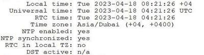

If you run command "date" on the machine where the MP is running, what's the output?
Please find attached the screenshot from server .
That looks correct then.
