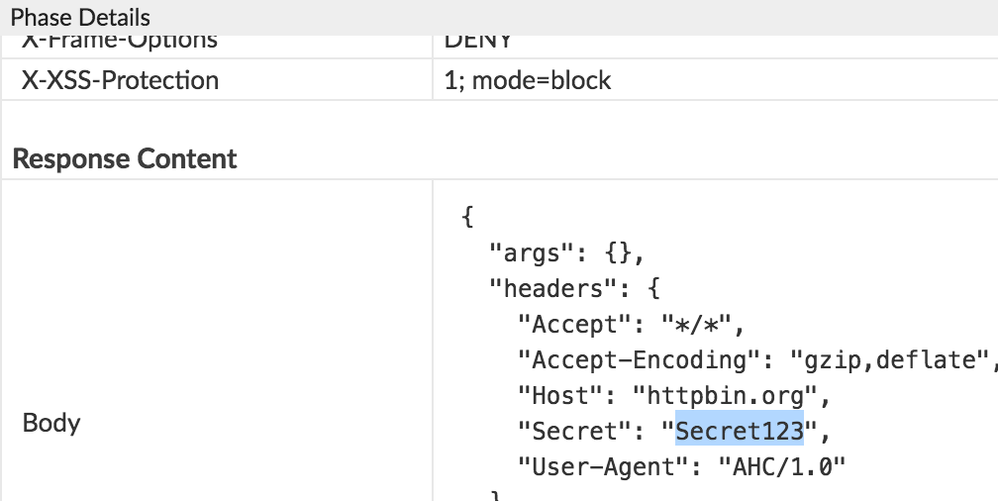

I tested with the value "Key1-Secret123" and got back the same.
Maybe you added the value "Key1-secret123" before and cache was not expired when you sent the request again? If that was the case, you can update the value in your KVM using management API as this will update the value immediately.

you must be doing something wrong. I have following the steps you have mentioned and see the output as same as input.
Please share the test proxy if possible so we can have a look in the exact issue.
