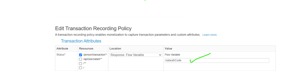

I am using an on-premise Apigee and I have a scenario in which I would like to set monetization on one proxy containing one API, but I have a service callout policy.
How can I check if the callout service returns 404 and the current API returns 200 then calculate the transaction?
I used many ways and solutions but I am stuck can I use costume  JS code that will check both of the codes and then add a new floe variable named nabeahCode its value is '690' then check it inside the criteria like below?
Show More
Transaction Success Criteria txProviderStatus == '690'
0 8 456

@williamssean and @Hilda_Arteaga Thank you for your time and effort after 3 days I found the solution to the problem that I am using $ sing within the flow variable once I removed it then everything worked fine as expected.
what I did in JS if these conditions are correct
calloutResponse.status.code == "404" and response.status.code == "200"
If the above condition is successful inside the JS success, I create a flow variable named nabeahCode = '204'. if it is made then the transaction will be calculated. I used the "204" code in the "criteria" but I think as You mentioned the "OK"  is better 👍
