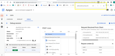

1. Just starting today I'm facing this issue where the new UI on Apigee X is enforce and I do see the option to SWITCH TO CLASSIC but when I click it doesn't work.
I tried clearing my cookies, on different browser & Incognito, doesn't seem to work (PFA screenshot of infinite loading when click SWITCH TO CLASSIC).
2. With new UI when I DEBUG, I'm unable to view the payload/body section for request/response. I could be missing something can you/somebody help?
One alternative is to download the DEBUG session and look for it, but I'd prefer to see it on the screen which is much easier (PFA screenshot & associated DEBUG log as a code block since I was unable to attached a json/txt file, again not sure why, something changed? The log in the code block is curtailed and not complete due to char limit).

I agree the new UI needs a bit more work to make viewing data at key locations (request received, target sent, target received, response sent) more obvious, the UI team is working that issue. I too expect to see the request details when you select "Request Received from Client".
To see the request payload click on "Proxy Request Flow Started" and see the content in the details on bottom right.
Thanks @kurt - much appreciated. You're a saviour as always 🙂

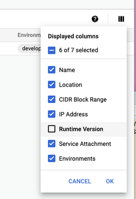

You can check your runtime instance by checking "Runtime Version" on the instances tab, my version is "1-9-0-apigee-16".
I'm not seeing request headers via the DOT going to target in DEBUG.
Thanks @kurtkanaskie . Mine is also same: 1-9-0-apigee-16 and I do see the Response headers (on Response received from target server and Response Sent to Client) and Request headers (only on Request Received from Client but not on Request sent to target server) like you said.
