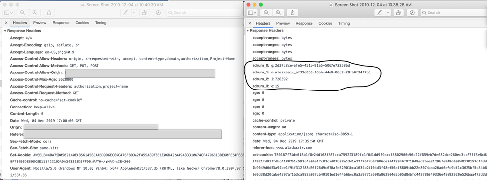

I am using AppDynamics APM to instrument my Java based applications behind Apigee and in my front end website I am using the AppDynamics JavaScript agent. I am NOT instrumenting the Apigee software itself as advised. I believe that Apigee is somehow blocking or preventing my request and response that AppDynamics is attempting to add to my AJAX calls which inhibits specific functionality.
On the left you'll see my AJAX request going through my environment using Apigee and on the right you'll see a "good" request that has the correct headers which are circled that does NOT use Apigee.
Request Headers:
Response Headers:
Do I need to set a rule to "allow" the "isAdrum:true" header? I've already set to allow the appd cookies per the AppD instructions in my AssignMessage rules..

First, a disclaimer: I'm not clear on the difference between what you're expecting to see, and what you are actually seeing. Is a header being blocked? Is the entire request being blocked? Does Apigee even see the request? (can you view it in the Trace UI?) I'm not clear whether the difference in what you expect and what you observe is in the request, or the response, or both. I'm not clear on what the "success case" corresponds to. Is there any Apigee involved in that transaction?

It looks to me that your AssignMessage that is intended to enable CORS does not include "Adrum" as an allowed header. It includes: origin, x-requested-with, accept, content-type, domain, authorization, Project-Name , but not adrum.
The effect of this, I would expect, would be that the browser would block any request that includes a header named "adrum". The browser doesn't "strip" the header and send the modified request. The browser will block the request entirely. If you remove that header from the outbound request, the browser will allow the request (* assuming that the remaining headers are all on the allowed list).
The difference between the successful case you have observed and the unsuccessful one, is probably that in the former case, the CORS preflight response includes adrum in the list of allowed headers, while in the latter case, the adrum header is not in the list.

Tried adding an adrum header with the value but it only added it to the response header and not the request. Do I need to create a separate policy to add this to the request headers?
