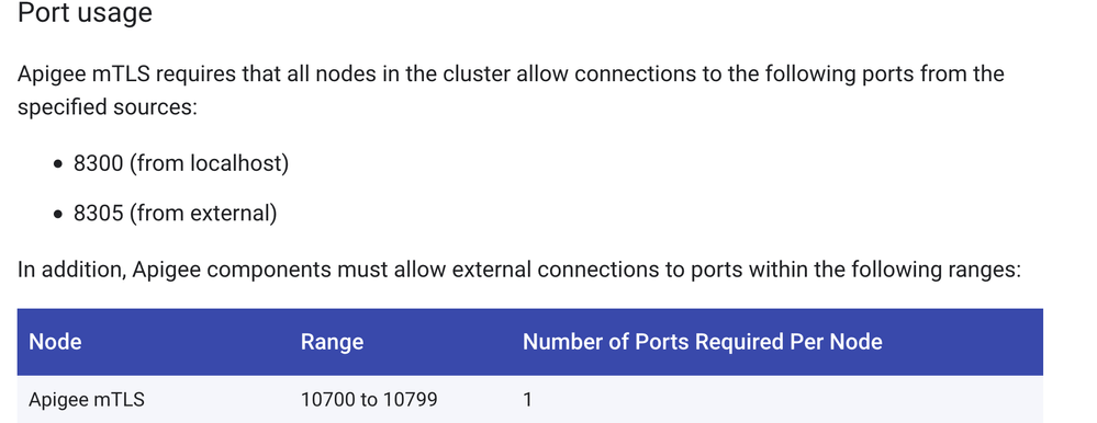

Hello Apigee Community,
On the Apigee mTLS documentation page,
I see the following requirements:
Does it mean, that each Apigee mTLS node communicates with other Apigee mTLS node via 8305?
For example:
Node 1 (Port 10700) communicates with Node 2 via 8305.
Node 2 (Port 10701) communicates with Node 1 via 8305.
Thank you in advance for help!

Hi Anton,
The 8305 port is used by the cluster members to talk to the mTLS control plane which is the consul server in this case. Each cluster member needs to be able to talk to the consul server ring using the 8305 port. However, it need be opened on all nodes but just the ones that are running the consul server and additionally you can ensure that only IP addresses allowed to connect to that port are the cluster member IPs.
This looks like a bug in the documentation after we made this change between alpha release and the GA release. I would file a doc bug to get this fixed.
In addition to that I believe it would be also beneficial to call out specifically what the following 3 ports are used for:
- 8300: Consul Server
- 8305: RPC port for communication with the server
- 8302: WAN port for gossip in multi-dc setup
Thanks for pointing this out. I would get the changes made asap.
