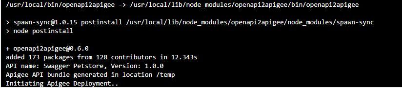

1. I am using the petstore spec for all my trials so far. And no, I could not get openapi2apigee to work for that as well. Below is the error I get and the command used.
Command:
sudo openapi2apigee generateApi petStore -s http://petstore.swagger.io/v2/swagger.json -D -d /temp -b https://api.enterprise.apigee.com/ -o XXX-eval -u username -p password -e prod
It fails with this
I will try the swagger-utility as well today. Thanks!
Looks like the :// characters in the url are getting encoded. Did you try setting the url in the pipeline variables and using it, or try enclosing value in quotes in your command line.
@Nagashree B I tried both - enclosing the url in quotes and using it as a pipeline variable, and in both cases I still get the same error.
