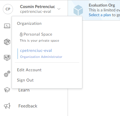

As for the prompt values, I think I input the right ones. My Apigee username is the e-mail address I used to sign in into Apigee Edge portal. My organization is cpetrenciuc-eval as you can see in the screenshot below

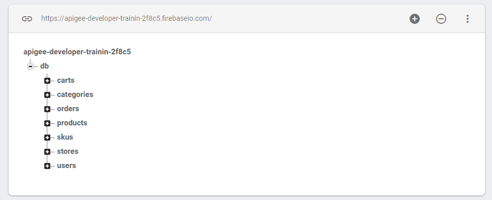

I entered "test" for the environment. For Firebase hostname I've entered "apigee-developer-trainin-2f8c5.firebaseio.com".
