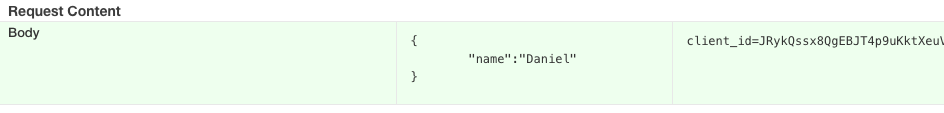

It looks like setting that context variable wipes out the request body. I've attached a picture from the trace.
