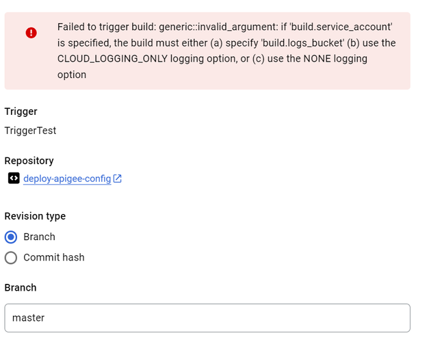

Hi All, Any idea why im getting this error and
how to solve this Failed to trigger build: generic::invalid_argument: if 'build.service_account' is specified, the build must either (a) specify 'build.logs_bucket' (b) use the CLOUD_LOGGING_ONLY logging option, or (c) use the NONE logging option
I have a repo created same as - https://github.com/GoogleCloudPlatform/apigee-samples/tree/main/deploy-apigee-proxy in google cloud repo im trying to CloudBuild trigger.png
Following is cloudbuild.yaml code
https://github.com/GoogleCloudPlatform/apigee-samples/blob/main/deploy-apigee-config/cloudbuild.yaml

@prmeyn - Are you configuring Cloud Build to use your own service account or are you using the default Cloud Build service account? The sample assumes the latter. If you are not using the default account and use your own service account, then you will need to make sure you give permissions depending on where you want to store the Cloud Build logs

@prmeyn - Thanks for the recording. You are not deploying the sample from that the repo you shared.
However for your Cloud Build to work, in the Cloud Build config page, in the service account section, make sure service account email empty so that the default is picked.

I'd  the same error, and I solved it by adding these lines in cloudbuild.yaml file and selected default service account
options:
  logging: CLOUD_LOGGING_ONLY
There are 3 suggestions, (a) specify build.logs_bucket, (b) specify CLOUD_LOGGING in the yaml file, or (c) specify NONE in the yaml file.

you can specify a service account in your yaml file. Also make sure it has the required priviledges.
serviceAccount: "serviceaccount@developer.gserviceaccount.com"
options:
Look into this article for a detailed overview of the configuration required.
https://cloud.google.com/build/docs/securing-builds/configure-user-specified-service-accounts
You should be able to resolve the issue by specifying
logsBucket: 'YOUR_BUCKET'
in your cloudbuild.yaml file.
