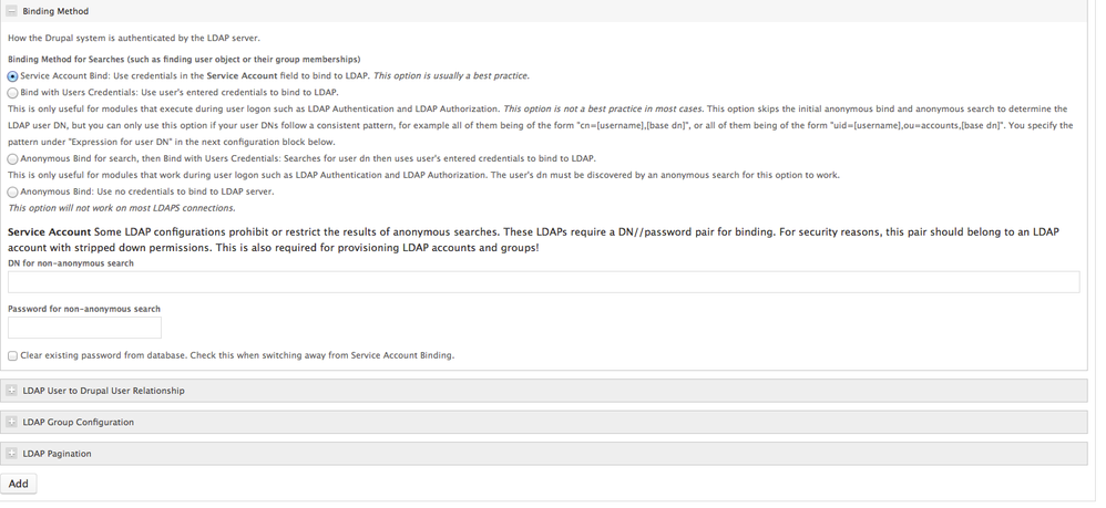

Is there any way I can find the meaning of different options at the navigation Configuration->People->Ldap Configuration->Servers->Add LDAP Server Configuration ? I'm trying to setup LDAP authentication to Apigee such that users who have access on the Apigee Dev Portal and the users authenticated by LDAP are able to access the dev-portal.
Note: My installation of Apigee is on premises.

I am attaching screenshots of the page, maybe that'll help expedite matters by bringing more clarity.
