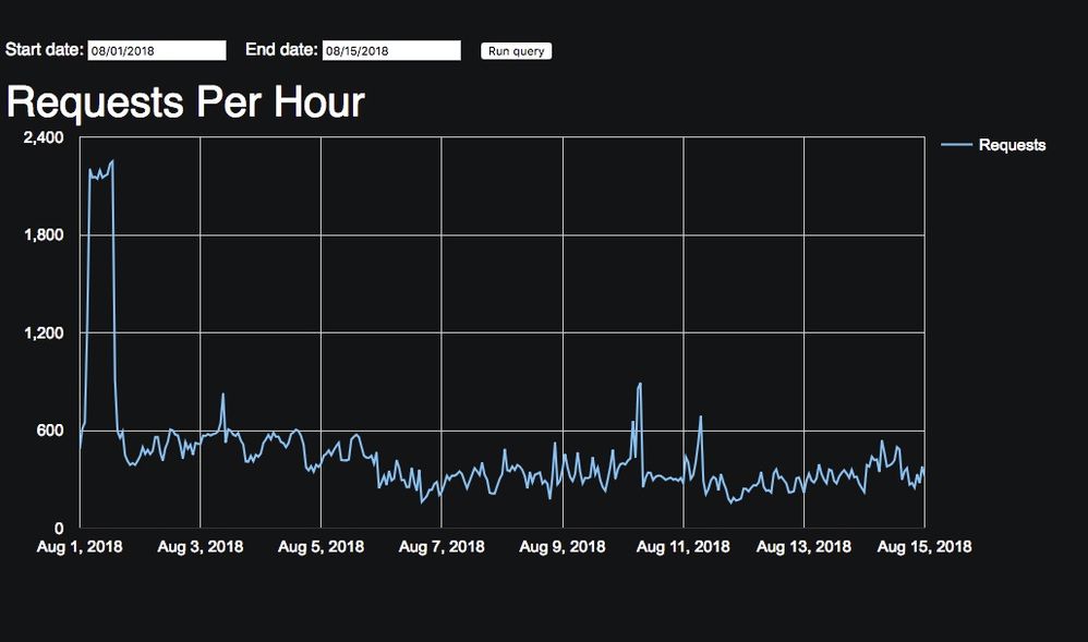

Yes, as @Dino-at-Google wrote, there are a lot of great options! I like Google Charts (https://developers.google.com/chart/) for creating nice looking graphs on a web page.
You can create a simple line graph with a little Javascript and a call to the stats APIs:
Here is the code for a single page web application that draws that graph. You can save the code to an HTML file and run it in Chrome. It will request your Apigee user name and password so it can get an OAuth token for the call to stats API. Once it has a token it will ask for a org name and environment, for example "myorg" and "test". You can supply a date range of a few days to see how it works. This is a quick example that is not robust or extensively tested.

Thank you very much! I will give this a try. My companies "edge" environment is secured with SSO so I think I'll change it to just accept a token that I get using a passcode and the "get_token" utility but this is a huge help!
@Mark Hammelman
Here is a simplified version that assumes you already have a token. I removed all of the token retrieval code and UI and replaced it with an input field for a token.

	       	// new variable, for convenience, to shorten the path
		    var counts = myData.environments[0].dimensions[0].metrics[0].values;
		    // sort data by timestamp
		    counts.sort(function(a, b) {return a.timestamp - b.timestamp} );
			// create the data structure for the graph
			var data = new google.visualization.DataTable();
			data.addColumn('date', 'Time');
			data.addColumn('number', 'Requests');
            // Build data for graph
            for(var i=0; i < counts.length; i++) {
				temp = [];
				temp.push(new Date(counts[i].timestamp)); // convert timestamp string to a Date
				temp.push(Number(counts[i].value));
	            data.addRow(temp);
			// Change format of tool-tip to show date and hours and minutes
			var date_formatter = new google.visualization.DateFormat({ pattern: "MMM dd, yyyy HH:mm"});
			date_formatter.format(data, 0);
			// Set chart options
			var options = {
				chartArea: { top: 10, left: 70 },
				width: 1200,
				height: 600,
				backgroundColor: '#1e1e1e',
				vAxis: {
				  textStyle: { color: '#fff'},
				  titleTextStyle: { color: '#fff'}
				hAxis: {
				  titleTextStyle: { color: '#fff'},
				  baselineColor: { color: '#fff'}
				legend: {
				animation: {
				  startup: true,
				  duration: 500,
				  easing: 'out'
				series: {
				  0: {
					  color: '#88C1F2'
			// Instantiate and draw chart, passing in chart options.
			var chart = new google.visualization.LineChart(document.getElementById('chart_div'));
			$('#chart_div').show();
			chart.draw(data, options);
		// set up UI for start and end date picker
		$(function() {
			$( "#datepickerStart" ).datepicker({ dateFormat: 'mm/dd/yy' });
			$( "#datepickerEnd" ).datepicker({ dateFormat: 'mm/dd/yy' });
    </script>
</head>
<body style="color: white; font-family: sans-serif; background-color: #1e1e1e">
<!-- application section -->
<div id="application" >
	<p>Org: <input type="text" value="org name here" id="org">
	   Environment: <input type="text" value="prod" id="environment">
	   Token: <input type="password" value="token" id="token"></p>
	   <hr/>
	<br/>
	<p>Start date: <input type="text" id="datepickerStart" value="08/01/2018">
	   End date: <input type="text" id="datepickerEnd" value="08/15/2018">
	   <input type="submit" value="Run query" id="queryButton">
	</p>
	<div style="font-family: sans-serif; font-size: 40px; font-weight: 400; color: white;">Requests Per Hour</div>
	<div id="statusMessage" style="font-family: sans-serif; font-size: 30px; font-weight: 300; color: white"></div><div>
	<!-- div for the graph -->
	<div id="chart_div"></div>
	<hr>
	<div id="responsecode"></div>
</div>
</body>
</html>
