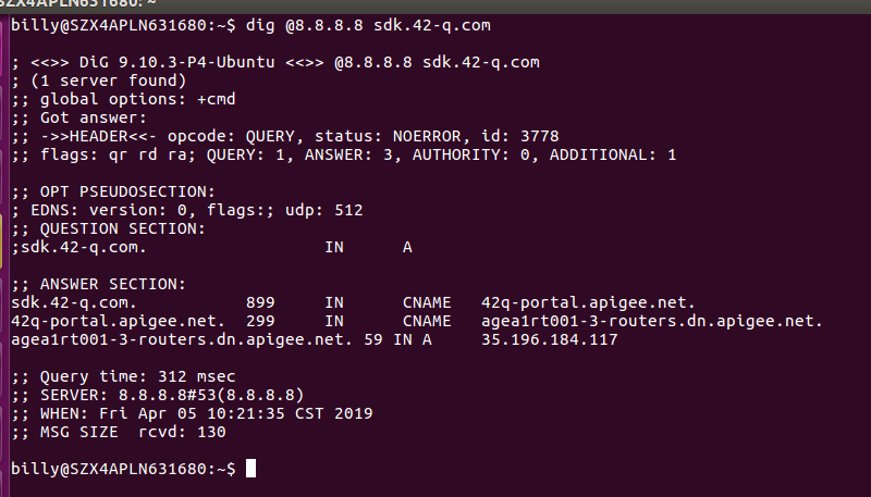

We have defined the custom domain follow up with https://docs-new.apigee.com/custom-domain but when we open the URL https://sdk.42-q.com on Chrome it always problem private issue.
Would you help to check where I am wrong which if I click the URL https://sdk.42-q.com on Chrome it always problem private issue.

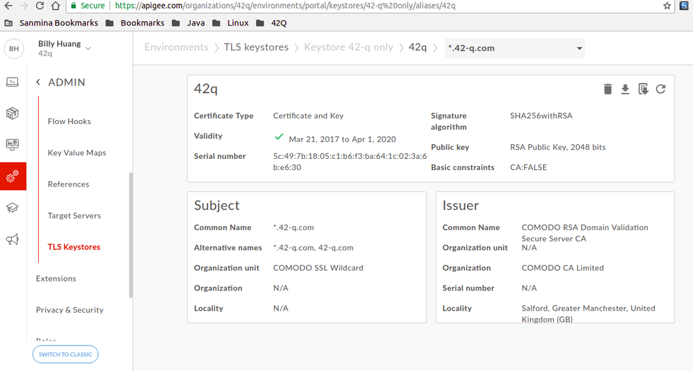

This issue was fixed after contact Apigee support team and fix with below steps:
1. Removed SDK keystore from freetrial and freetrial-2019-03-07. P.S.: Apigee support team told me that should has same Certificate key for same keystore.
2. Create a new keystore and create a alias with type = "Certificate and Key" or type = "PKCS12/PFX File". In my case, I use PKCS12/PFX File.
3. Create a New Key Store Reference & Update The Virtual Host
4. Ask Apigee support team to restarted Apigee Routers of your Apigee organization and it reloaded the updated virtual host configuration.
Noted: This step is very important as Apigee support team told me that this issue may have occurred due to the invalid TLS keystore configuration which was given previously. So, please confirm right TLS keystore was configured on step 1~3 if you need create a new virutal host or portal with your domain names.

Billy, you seems to have followed the correct steps but due to some reason the virtual host sdk.42-q.com:443 is returning *.apigee.net TLS certificate:
keytool -printcert -sslserver sdk.42-q.com:443 | sed -n -e 1,10p
Certificate #0
Owner: CN=*.apigee.net, OU=Domain Control Validated
Issuer: CN=Go Daddy Secure Certificate Authority - G2, OU=http://certs.godaddy.com/repository/, O="GoDaddy.com, Inc.", L=Scottsdale, ST=Arizona, C=US
Serial number: 4b379fe9a809fb0e
Valid from: Thu Jan 14 04:25:54 AEDT 2016 until: Tue Apr 09 16:37:10 AEST 2019
Certificate fingerprints:
 SHA1: 9D:71:67:74:5D:D6:A9:88:C7:07:3A:B4:D4:9C:CB:9D:DD:8C:C8:84
 SHA256: 0C:C2:D7:38:CD:FC:33:23:DB:C7:80:E2:15:69:71:A9:35:D4:9D:C1:E6:EC:9B:BF:9B:80:71:A1:B5:90:1F:47
Signature algorithm name: SHA256withRSA
I would recommend you to contact Apigee Support for this. The virtual host created by the dev portal may have not configured correctly.
