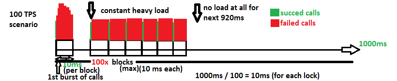

On the other hand customer doing rapidly extra 50.000 calls / second could kill my back-end service and I want to prevent it. I think one of the solutions is using your quotas per minute (then I will multiply limits by 60). Still it is not perfect as my big customer with limit 5.000 calls / second will be able to do (60x5) 300.000 calls in one second theoretically (and kill my back-end). Spike Arrest is not applicable imho. As if I'm reading documentation correctly it makes locks. In case of small customer with limit of 100 calls / second it will be making 10 ms locks. And then my customer doing 32 calls at once (in few ms) will get just one correct answer and rest of calls will be blocked - right? (of course this is not acceptable for customer). Additionally how spike arrest would work for my big customers - doing 5000 calls / second. Would Apigee calculate lock to nanoseconds and put lock and unlock user key in nanoseconds? Any hints how to solve it? How you would migrate my DDOS protection mechanism to Apigee?

I even made a graph presenting how 'spike arrest' would work for my example small customer. Please correct me if I'm wrong. My understanding so far is that spike arrest is not the way to go if we have customers doing rapid bursts of API calls. (I guess spike arrest would work fine if my customers would use API in consistent manner - with more or less constant speed (tps))
