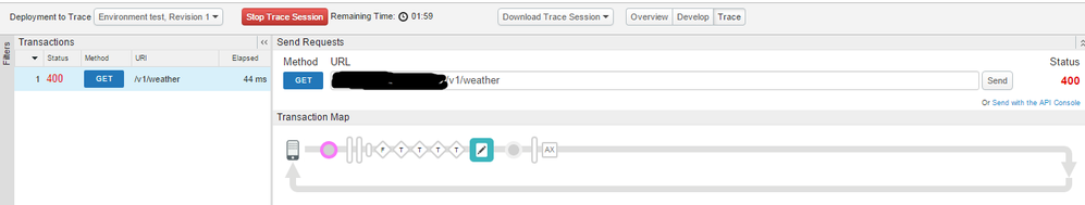

Default fault rule worked in the case where no fault was able to catch the exception. But it is also executing when another fault is raised. Even when <AlwaysEnforce> is false.
Attached is the screenshot of the trace. Below is how I am applying the default rule

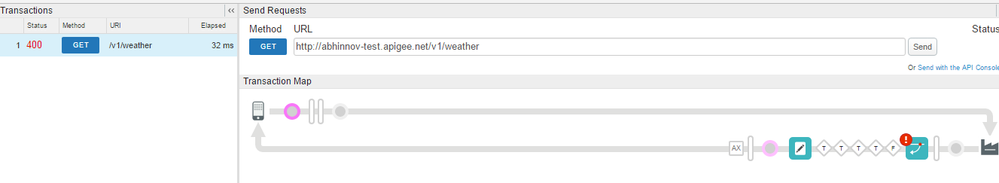

Hi @sgilson, @Vijay Muralitharan, @Arun Kumar Reddy,
I just tested this in Cloud (150930.01) & On-Prem (4.14.07.00). The On-Prem works like a charm. I have also attached snapshots of both.
@Anil Sagar,
This looks to be a bug in Cloud (150930.01). Please address this.
Cloud -
On prem -

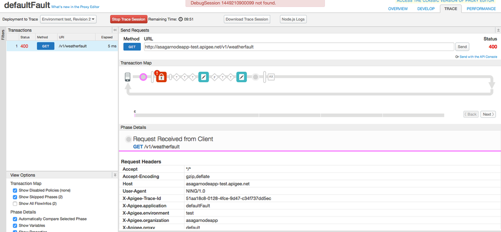

Dear @Arun Kumar Reddy , @Abhishek Subramanya ,
It works as expected on cloud too. Please find attached proxy & details.
Only , one raise fault is executed on default , Always Enforce "false"
