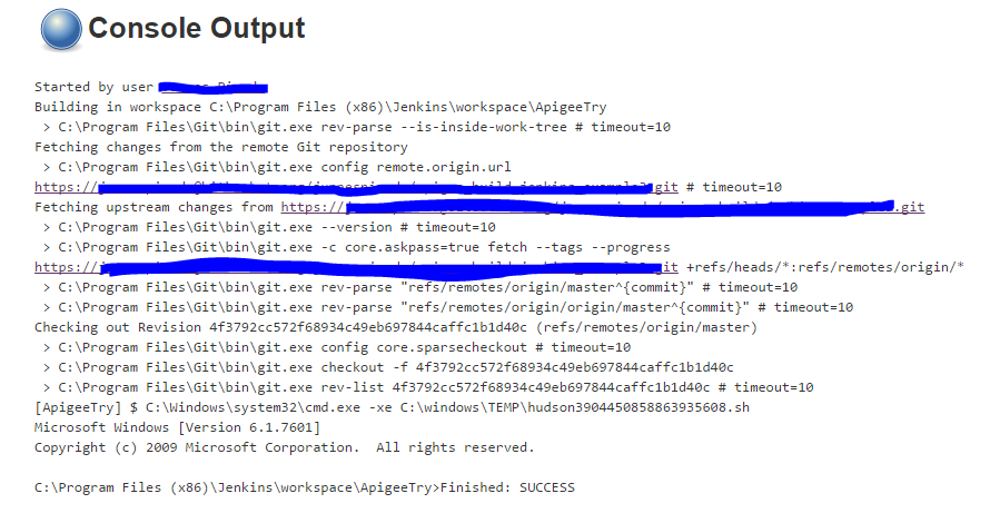

@Anil Sagar thank you for your response. I am getting this output on Jenkins. I have no idea if it is the right output since there are no screenshot provided on the tutorial link but I followed the steps indicated there.
@Junnes Ashley Pineda , It's just checked out the code from GIT. It didn't run any build / deploy proxy to Apigee Edge. Are you sure you have configured Maven / Provided Apigee Edge information in Jenkins Job Configuration ?
@Anil Sagar No, I haven't configured anything in apigee edge yet. And regarding maven too. I was not able to access the repo in git so I just import it using bitbucket and was able to copy the files in git. Thanks Anil.
@Junnes Ashley Pineda , Sorry, mybad, Above article is using the apigeetool instead of maven. Are you sure nodejs is installed in your machine ? And also i see you are using windows machine, above article is written keeping in mind unix / macosx.
@Anil Sagar yes, the nodejs is installed. as well as the apigeetool. But how come that it is working fine on Jenkins? even if I am using windows? thank you.
