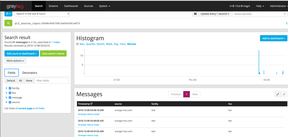

STEP4 : Graylog will Display Messages in the configured HTTP listener as shown Below
