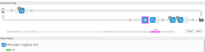

First approach : Logging policies using service-callout in proxy postflow - displays the variables and it works
First approach: Logging policies using service callout in post-client flow : doesn't work(not fetching data from KVM)
Second approach: leveraging builtin 'MessageLogging' policy in post-client flow:
@dknezic/@apickelsimer  Would appreciate any reply.. Thank you !
When you get a chance, please respond to my previous question and/or share your proxy xml config
@dknezic : I replied in the above post with the policies and screenshots I am using in 2 approaches:
Also please find the proxy xml config below for the 2nd approach using only 'Messagelogging' policy:

Your trace seems to show other policies as well? (Other policies could prevent policies from running in post client flow or could be manipulating the response or other variables leading to missing data)
@dknezic/@apickelsimer : In second approach, I added 'Messagelogging' policy inside shared flow in postclientflow.. No other policies are present in the shared flow.. Also I tried with only 'Messagelogging' policy in postclientflow instead of keeping it inside shared flow.. that also did not work !
Is there any other thing that could be prevent Messagelogging in sending logs to cloud logging explorer?
