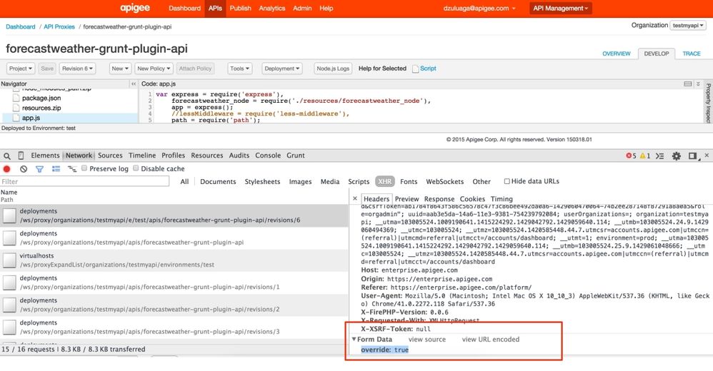

In my experience, I was able to workaround the issue above by saving my changes as a new revision, and subsequently deploying the new revision. What this effectively does is to import a new revision and then overriding the previous deployment with the last revision. In this case, if you turn on developer tools, you'll observe that the resource /{apiproxy_name}/revision/{revision_id} with method POST will include the variable mentioned above by @sudheendra1. Check image below.

Proxy deployment could take time depending upon the policies and resources present. Did you try setting the "override" attribute to "true"? When you set this to 'true', it forces deployment of the new revision by overriding conflict checks between revisions. You can set this parameter to 'true' when using the 'delay parameter' to minimize impact on in-flight transaction during deployment. You are right.. Apigee Management UI uses this parameter while deploying.

There is no 'delay' parameter that is being set by the UI when deploying a new revision . It does only override . Even in the case of saving as a new revision there will a minimal downtime and its not 100 % zero downtime but using APIs and offline tools we can achieve 100 % cc @dzuluaga , @sudheendra1
